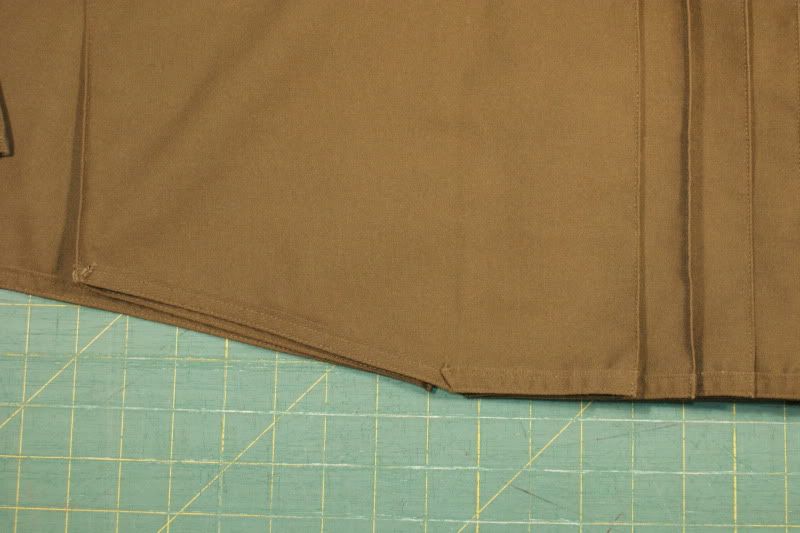

    From your description I think you are referring to what we call "apron tips". This is the hem in the deep and reverse pleat that would hang down below the lower edge of the aprons if not turned up and sewn.
    Here are some photos of this turn up of the apron tips.
    if you look at the aprons on both the deep pleat, or right side, or the reverse pleat, or left side, the hem of the deep and reverse pleats should not hang below the hem of the aprons.

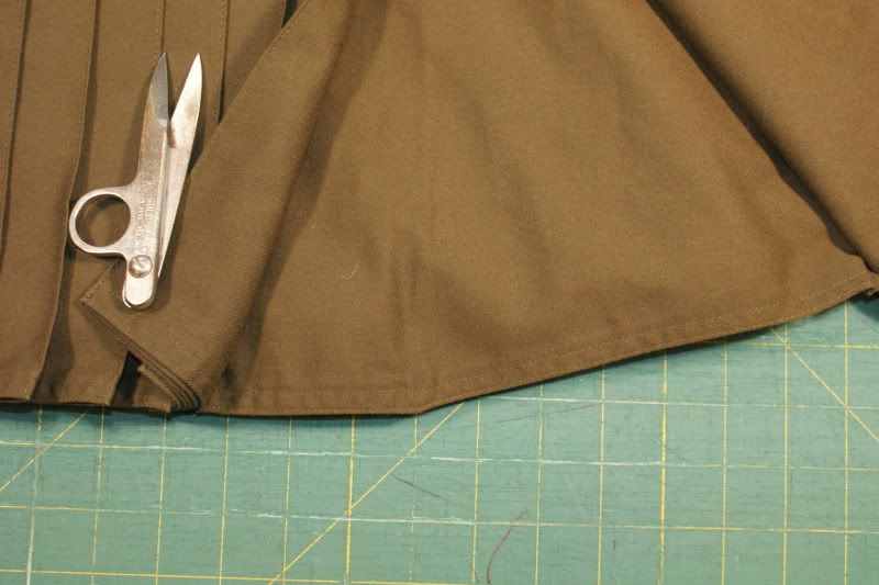

    Here I have lifted the apron to show where the apron tips have been turned up and sewn.
    We use two methods of dealing with apron tips. One you can see here.
    Looking at the hem of the reverse pleat from outside.
    And what it looks like from the inside.
    You can clearly see where the hem of the kilt is cut on an angle before the kilt is pleated. The angled area is hemmed as we sew the entire hem of the kilt. This method requires good angle measuring and precise hemming. It is fairly time consuming.

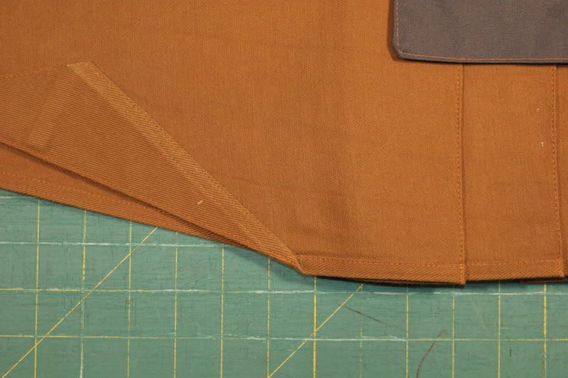

    Another method we borrowed from Tartan kilt making.
    The hem is turned up after the kilt is pleated.
    Again looking from the inside at the reverse pleat.
