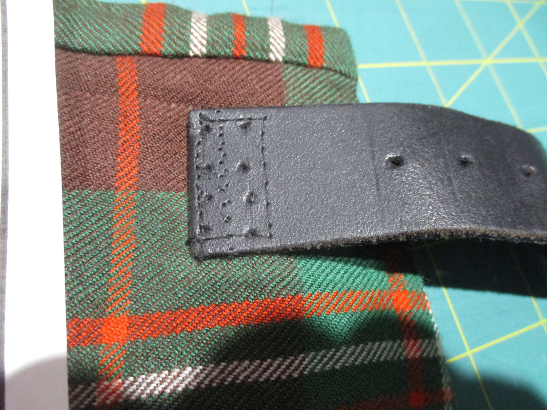

    The very first thing I noticed about this kilt is that while the straps were originally sewn by hand they were re-sewn by machine.
    I also noticed right away that the Fell area of this kilt was very floppy. It did not stand up on its own the way I make a kilt.
    I next did the stretch test. Pulling on the buckles to see if the stress of strapping the kilt on would be transferred to the outer Tartan fabric and the hand stitching.
    This kilt failed the stretch test.
    You can see where the outer Tartan fabric has been stressed enough that the stitching has been pulled and is now showing.

    In this kilt the straps are not anchored to anything other than the apron facings.
    You can easily see the distortion of the Tartan fabric when the straps are not anchored.

    And as I suspected the buckles and straps are sewn only to the outer Tartan fabric. A kilt can have the best interfacing and stabilizer in the world, but if you do not anchor the straps and buckles to that interfacing and stabilizer - Well then, why even put it in there in the first place.
