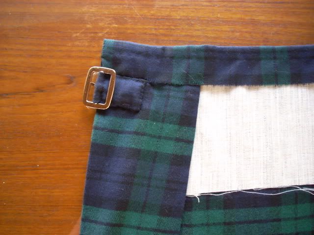

    Just finished my first installation of this style strap and made one mis-step that I will pass along in hopes that others might avoid it. Not really a "mistake" or I'd have fixed it
    I made a loop and attached buckle to edge of underapron much the way that outer buckle is attached. But I did this before lining the underapron. In retrospect, I'd have waited and stitched in BOTH the buckle and strap after applying kilt lining.
    Here's my inner buckle sewn in prior to lining. I then found it difficult to neatly sew the lining underneath the buckle (it's laying cattywhampus in this photo, but correct orientation is easily determined when you are holding all the bits together in your hands).
    Other than that, it went in like a charm and seems to be working beautifully. Thanks again to the originator and supporting cast!
