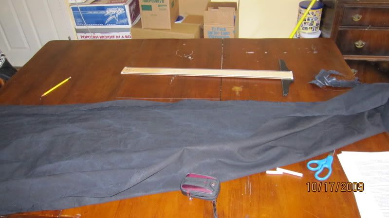

    Ok...I had to reduce my apron size to 11 inches for simplicity's sake. Math was gettin to messed up... So I'm going with an 11 inch apron, with 13 3 inch pleats, and i rounded my rump to 50 inches. Does this seem right? Or do I need to go with like...a 20 inch and 10 pleats? Remember we're talkin a 50 rump, a 51 waist, and i'm still hoping for a narrower apron. Also, here be pictures.
    I got all my supplies together. Then grandma told me it was time to go get burritos. I happily obliged.
    Anyways, then I made my apron strip.
    I know it looks messy, but I made sure it was SUPER TOUGH.
