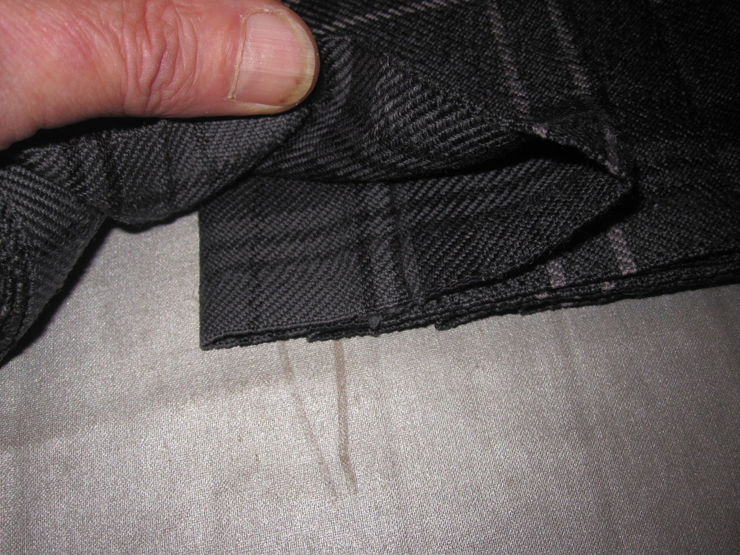

    Perhaps a photo of an actual fabric join will help.
    If you are hand stitching - This is called a "Flat Fell Seam".
    If you are machine stitching your kilt - This is called a "Sailmakers Seam".
    Please notice that both of these produce a seam where there are no raw edges of fabric to fray. A serger is not used to finish the edges they are folded in or stitched over depending on you method of stitching.

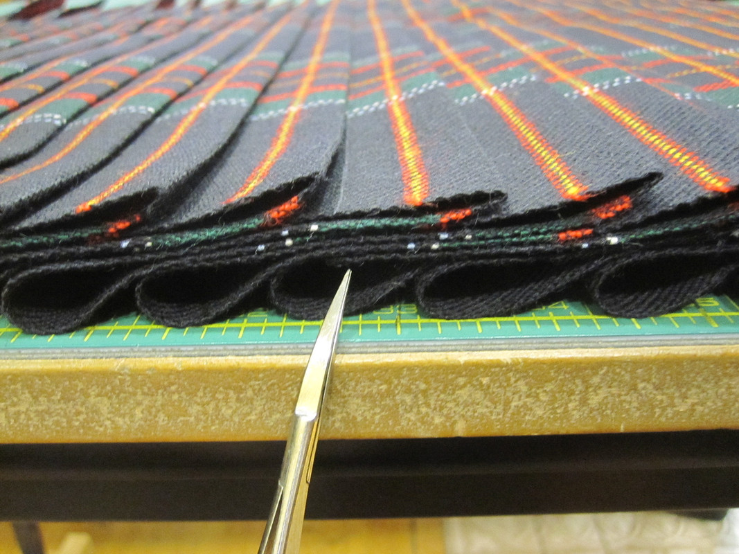

    I used a product similar to Anne's (Pleater) description. Here is a photo of the type I have used.
    The tape is paper with adhesive but not as thick as masking tape. I had to use a stronger needle on my sewing machine and sew at a slower speed.
