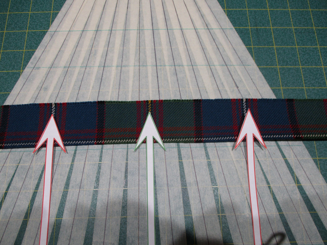

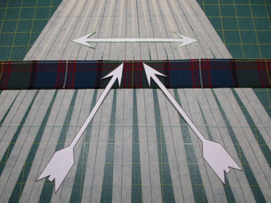

    And I lay out pleats using a different method.
    If I may offer - This method was knicknamed "The Magic Starburst" by two of my students.
    You begin by cutting a strip with the same Tartan element that you have chosen for the apron center in the center of the strip.
    This strip is long enough to reach around the back from side seam to side seam
    On the back of your strip, iron on a piece of fusible interfacing, to insure that the strip is stable and will not stretch and also to give you a good surface to mark on.

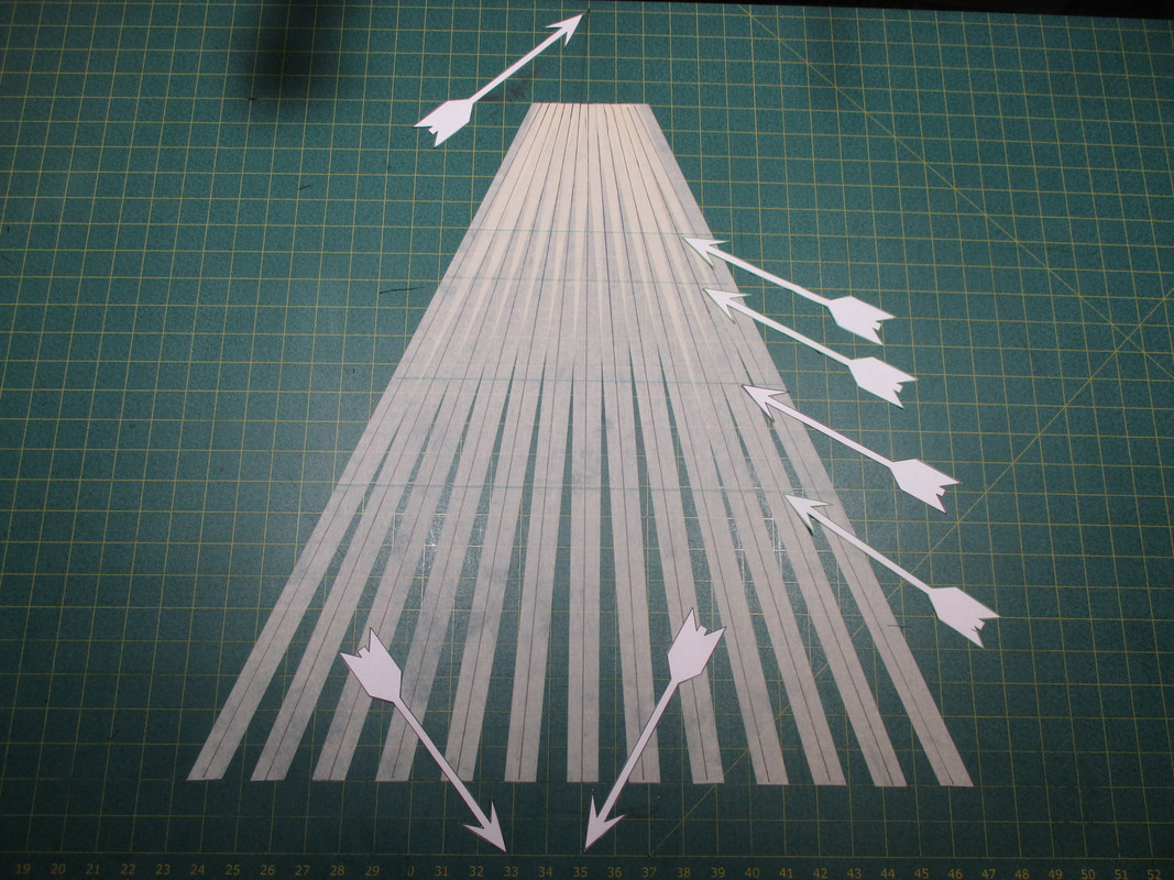

    Then on any table you lay out a set of lines.
    These start at a single point at the top.
    And at the bottom are equally spaced.
    (masking tape used only to highlight the lines)
    Up near the top you find where the spacing between lines is equal to your chosen minimum pleat reveal. ie 5/8 inch.
    Lower down you find where the spacing between lines is equal to your chosen maximum pleat reveal. ie 7/8 inch.
    Then lay your strip on the lines anywhere between the minimum and maximum spacing.
    Move the strip up and down until the pivot points of the Sett are on any two lines.
    This divides the Sett into equal spaces.
    Then move the strip side to side looking at where the creases of the pleats will fall within the Sett.
    What you watch for is that no element will disappear when tapering creating spear points, and if possible, that no element falls right on the edge of a pleat. (an element can be along a pleat edge, you just must be careful in tapering.
    When pleating to Sett you also want an odd number of pleats so that the same element that is centered on the apron, is also centered in the back center pleat.
    This method insures that the full Sett is maintained and that the relation of the elements of the Sett retain their relationship to each other.
    This method also allows you to divide any Sett into any number of equal pleats that you desire. If your first try does not work simply repeat the "Up-Down - Side-to-Side" again.
    Draw marks at each line of the magic starburst.
    Then when you are laying out your pleats on your fabric you can just lay the strip right on the fabric aligning the Tartan and directly mark out your pleats.
    I know and understand that some people do not like my method but I have used it on hundreds of kilts, hundreds of different Tartans, and it has worked every time flawlessly.
