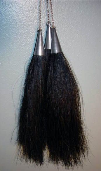

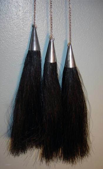

    Here's a set of horse hair tassels I've just sent out.
    These were commissioned.
    The little ring riding right at the top of the bell is to prevent the chain sliding out of position during shipping, and is removed once the tassels are installed in the sporran.
    In the near future I hope to start making the bells from brass, nickel, and cast pewter (ornate Victorian style).
    I'm still experimenting with various sizes of bells, as well as patterns for the bottom edges of the bells and pinked leather trims that rest between the metal and horse hair.
    This project gets more and more intricate every time I do something..
