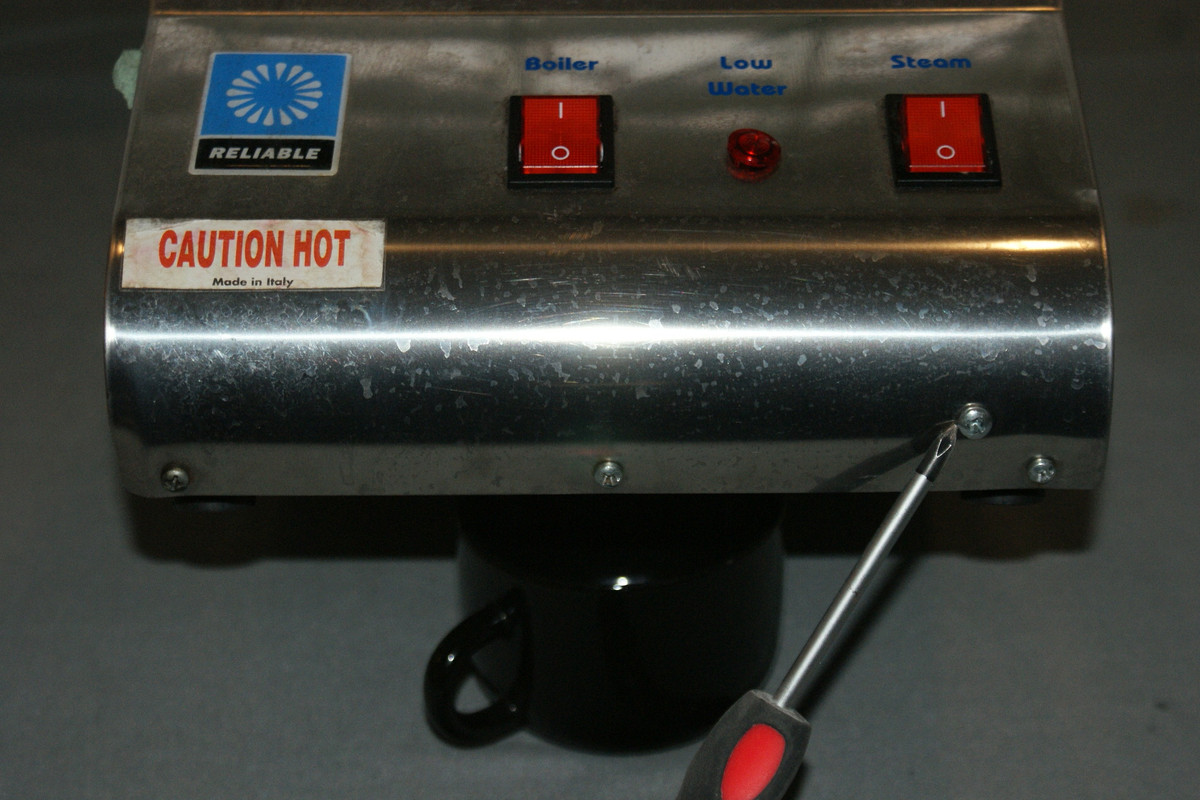

    First un-plug the iron and remove the water fill knob.
    Then you will find three screws on the lower front. Do not remove the fourth screw where you see the screwdriver pointing.

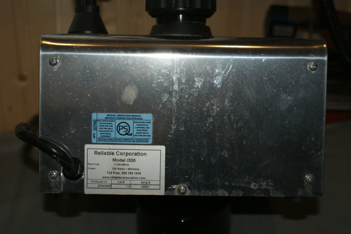

    There are also five screws on the back.
    Then gently lift the top up about six inches. Careful as there are wires going to the switches.

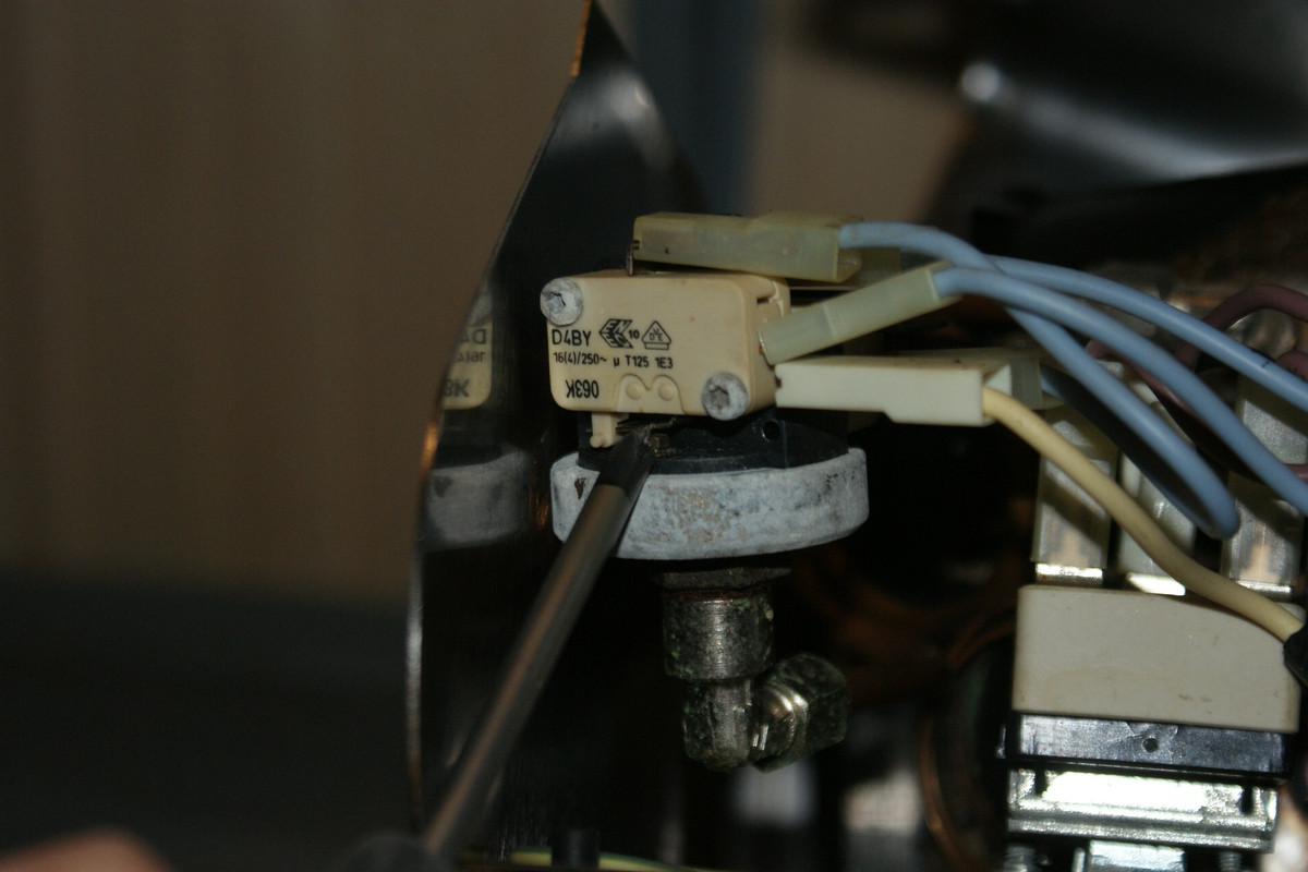

    The circuit breaker is located on the left just above the round pressure sensor under the rectangular part.
    It is a small metal lever. Push up on that metal lever and you should hear and feel the circuit breaker re-set.
