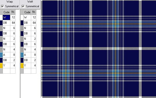

    The thread count for the X Marks the Scot Tartan is written -
    /W12, DB64, N6, DB6, N2, DB6, N4, A8, DB2, Y4/
    With the "/" symbol denoting the pivot points of a half Sett.

    And as stated by Figheadair the thread count will be written in a specific format using an accepted shorthand.
    And if written for a weaving count it would be W/6 DB64 N6 DB6 N8 LB8 DB2 Y/2

    Thanks for clearing that up Peter, I had often wondered as I have seen thread counts in both formats and did not really understand the difference.
    But now that I can see both formats for the same Tartan it makes sense.
