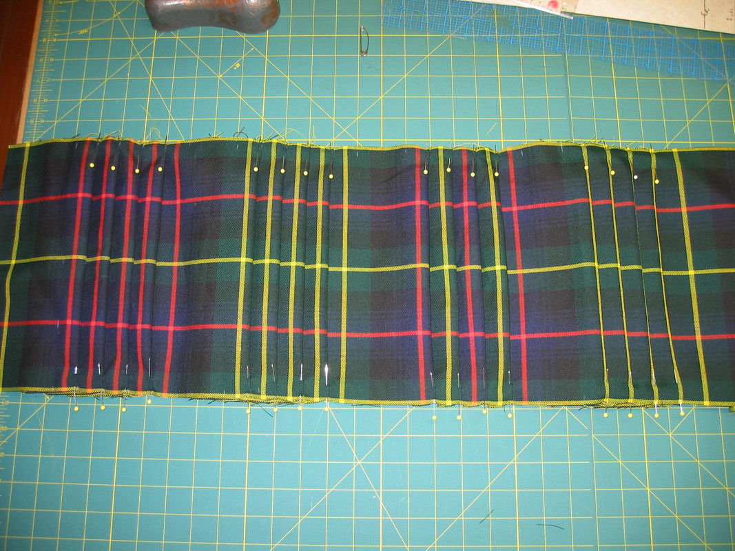

    Hi Paddy. Indeed it is possible. It isn't done often, I don't think. That said, the Canadian Scottish Regiment wears Stewart Hunting and alternate the stripes with the red and yellow. It is commonly referred to as "ketchup and mustard". MacEwan is very similar and could be pleated in the "ketchup and mustard" pattern, if you wished.

    Some Tartans like Stewart Hunting look good pleated alternating.

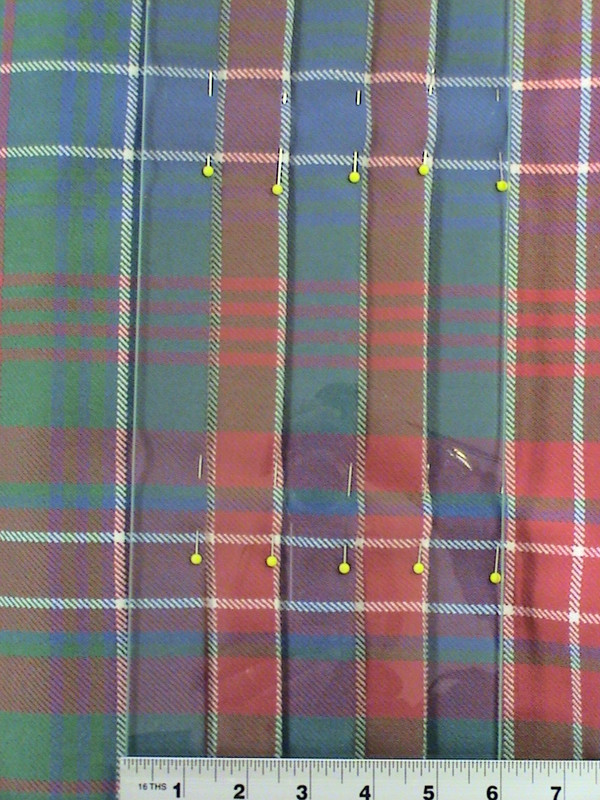

    And the X Marks Tartan.

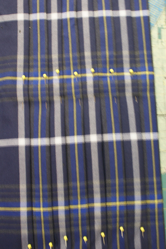

    And some - like this Wilson - not so good.

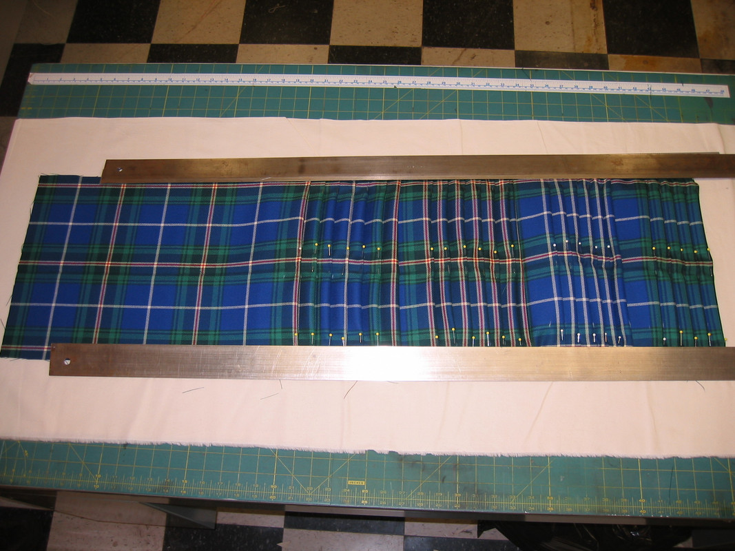

    I have always suggested to a customer who is unsure, to have their kilt maker pleat up samples and send photographs via email. As in this pleating sample of Nova Scotia.

    As pointed out above Hunting Stewart is a special case due to the red and yellow lines alternating across an otherwise symmetrical tartan.
    Black Watch-based military kilts with one or more light overstripes are generally pleated to them, so that Gordon shows a yellow line on each pleat and Seaforth MacKenzie shows a white line on each pleat.
    But on Hunting Stewart pleating to either the red or yellow means massively deep pleats and a vast amount of tartan being swallowed up in them, thus the alternating pleating to both the red and yellow lines.
