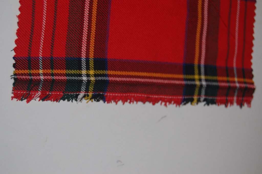

    I am making a PV kilt and it came with a fringed selvedge. What do I do about it? How do I make the bottom of the kilt look nice?

    You have two options. You can make a hem on the fabric before you start sewing, or you can leave the fringed selvedge as is. USA Kilts used to leave their PV kilts (they might still do, but I have not purchased a PV kilt in years) with that fringed selvedge, and it looked good.

    Marton Mills only began including a selvage on their PV fabric fairly recently, so less popular tartans of which they still have older stock won't have it. But USA Kilts buys PV by the bolt, so all of their casual and semi-trad kilts have a selvage now.
    I've made kilts and kilted skirts from seven different PV tartans, three of which did not have a selvage. So for those I folded and pressed the bottom edge in about half an inch, and only once, as doing it twice would result in a bulky hem. Since they were to be machine-sewn and thus have visible stitching at the fell and waistband, I simply used an ordinary straight stitch with the machine to secure it. However, if your kilt is to be hand-sewn, you'll probably want to use a blind hem...which someone else could probably explain better than I can.

    Fringed selvedge - although the term is used, it's a contradiction Cloth can have a selvedge, a tuck edge (definitely not a selvedge) or a raw/unfinished edge. You cloth is the latter and is not intended for kilt making, hence your problem. An unfinished edge is normally hemmed if the cloth is to be worn, for example; as a skirt. You could try hemming it but the bulk will probably affect the hang of the pleats if you do. Start again with a different length of cloth?

    Technically it is a selvedge which is an edge produced on woven fabric during manufacture that prevents it from unraveling, not one that's ideal for a kilt though. Having said that I have at least 10 kilts I've made from the Marton Mills P/V with that type of edge.
    Here is the selvedge prior to hemming
    And after hemming
    It was machine sewn and unless you're examining it from a few inches you can't tell, also the material is relatively light so the hem isn't bulky

    I have to disagree. Technically, it's not a self-edge. Traditional selvedge decoration on tartan cloth

    I see two edges in the photo Bert posted. One is caused by pinking shears and one appears to a manufactured edge with a hem.
    Which is the focus of the thread?
    Here is a photo of my pinking shears. Just for clarity.

    Mine is a Maron Mills PC, and I find the fringed selvedge not to my liking. I am going to put in a hem. Ideally, I not what I want, but I don't really think it will be anything someone would even notice or care about unless they were inspecting it up close.
