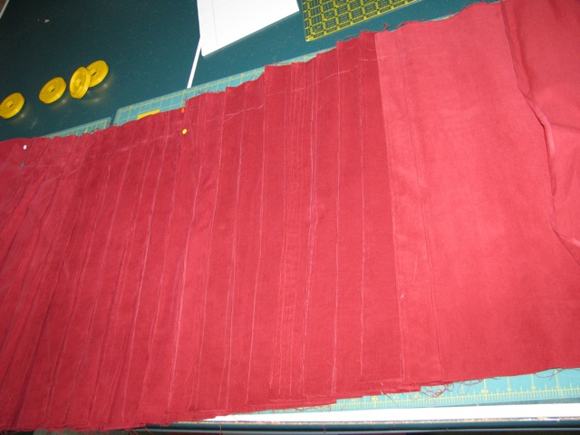

    (Well, I did start figuring out the pleating several times, but I got confused, and kept having to start over. thus, the month break.) So, the other day, i worked out what I could do with my 287 inches of cordury (besides make a handy red carpet.) That's just an inch short of 24'. That's a long piece of fabric to deal with, it turns out. I had a fit of lazyness, and decided that I'd do the center box pleat, 9 uniform knife pleats on each side, with a 1.5" reveal, plus generous first and last pleats and aprons. A bit of math reveals that the pleats will thus be 4.5" deep, and overlap lots.
    that's it pleated. The left hand side pleats are sewn down, the right ones are just folded.

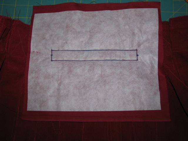

    A couple pictures:
    The welt patch for the right hand rear pocket:
    part of cutting out the welt, showing how many layers of fabric are involved:
    (11, if I'm counting right...)
