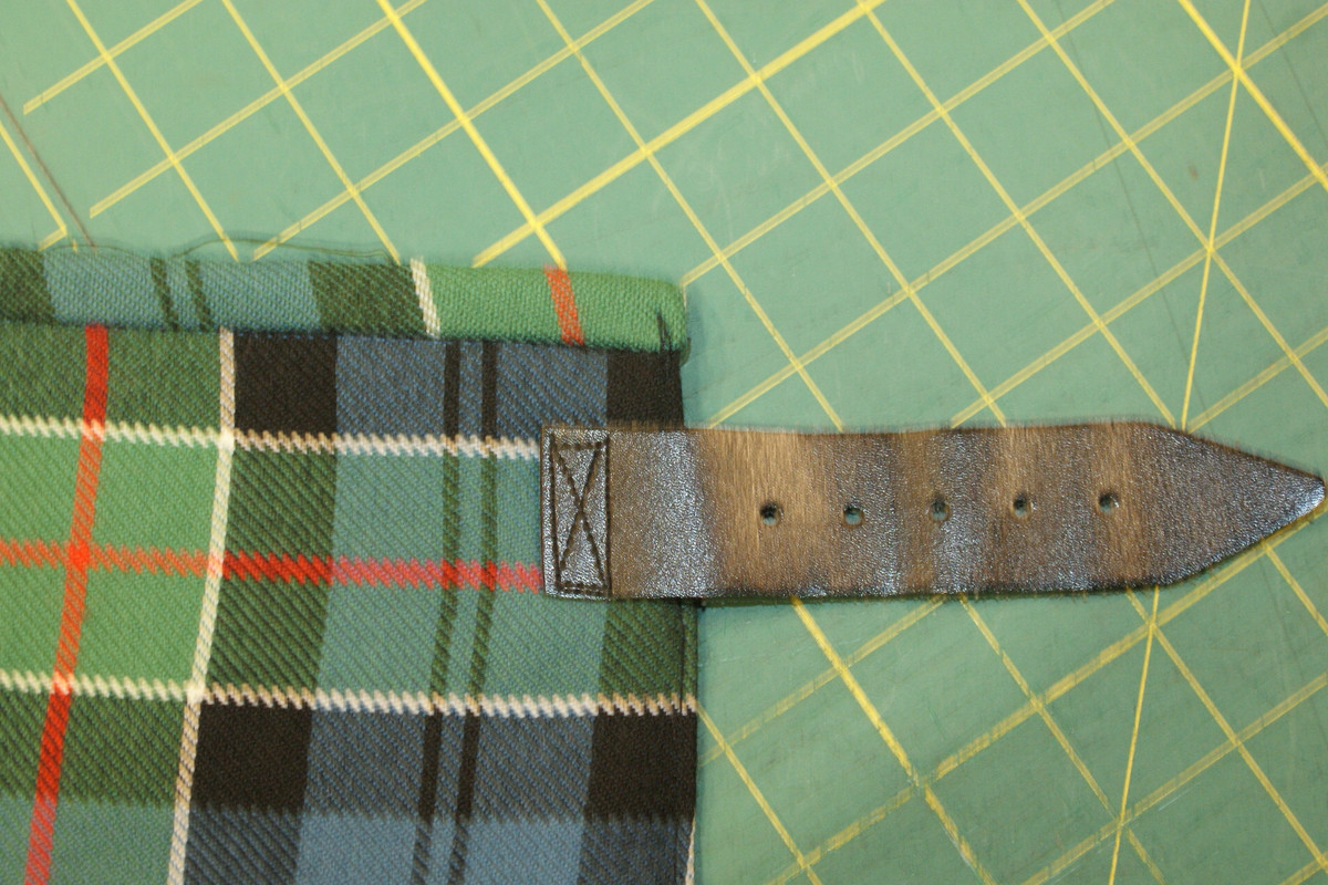

    Now, here is a detail of the under-apron strap.
    Please note the distortion of the fabric in this area. There is no pull on this strap. It is just laying on my table. This distortion of the fabric is now permanent and is caused by a similar problem as we saw in the back of the kilt.
    Next I will begin to figure out what is going on here and come up with a plan to overcome it.
