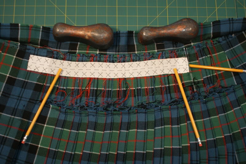

    Re: Do kilts have a "break-in" period?
    If you have been watching this thread you know we are now ready to start putting this kilt back together and get it back to Tobus so he can enjoy wearing it again.
    The first step is to install the stabilizer to the inside of the kilt. The job of the stabilizer is to give strength to the back of the kilt between the buckles as you have seen.
    Last night as I was watching TV I sewed the stabilizer into the kilt. Here is a photo of the finished stabilizer.
    The white strip of fabric is the stabilizer itself. This is carefully cut from a piece of cotton similar to a bed sheet. This fabric is very strong along the grain or weave. It does not stretch very much so, while light weight, makes a very good reinforcement.
    I thought it best to stitch this using a white stabilizer and black thread so you could see the stitches better. Notice how many stitches there are. The stabilizer is stitched to the back of all the pleats to anchor it and reaches across the back of the kilt from one buckle to the other.
    You can see one pencil stuck through the strap hole and the other two point to the location where the buckles will be sewn on the outside of the kilt.

    Or you can have a little fun with the stabilizer, because it never shows (unless someone like the Wizard deconstructs your kilt....). I always use American flag cloth.

    An interesting thing to note is the stitching on the two stabilisers just posted, very interesting to see thats there's more then one way to do things

    There are many ways to do the stabilising strip,I use old and fine linen shirts!
