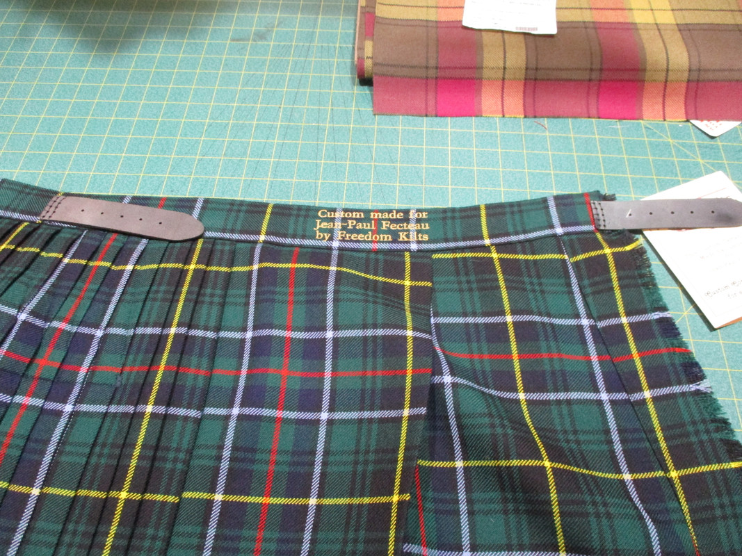

    A full Contemporary kilt can be stitched by hand or by machine. Even my machine stitched kilt have a stabilizer.
    However, machine stitching compresses the layers of fabric so the result is about the same effect as what the interfacing does. Provides vertical stiffness to the garment and allow the pleats to hang and swish properly. So additional interfacing is not required on a machine stitched kilt made this way.
    The stitching provides about the same vertical stiffness as interfacing. The back of the kilt will still stand up all by itself. In places this kilt has 8 layers of fabric stitched together into a uniform and integrated unit by machine.
    The horizontal strength, to keep the stress of strapping the kilt on and moving in the kilt, is done with stabilizer. This is a strip of very strong fabric that does not stretch. Much like an internal belt. The stabilizer is hidden inside the back of the waistbanding. This is where the straps and buckles are fastened.

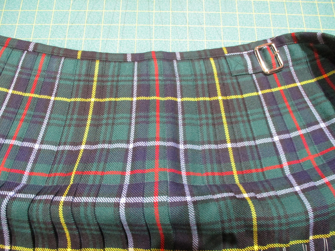

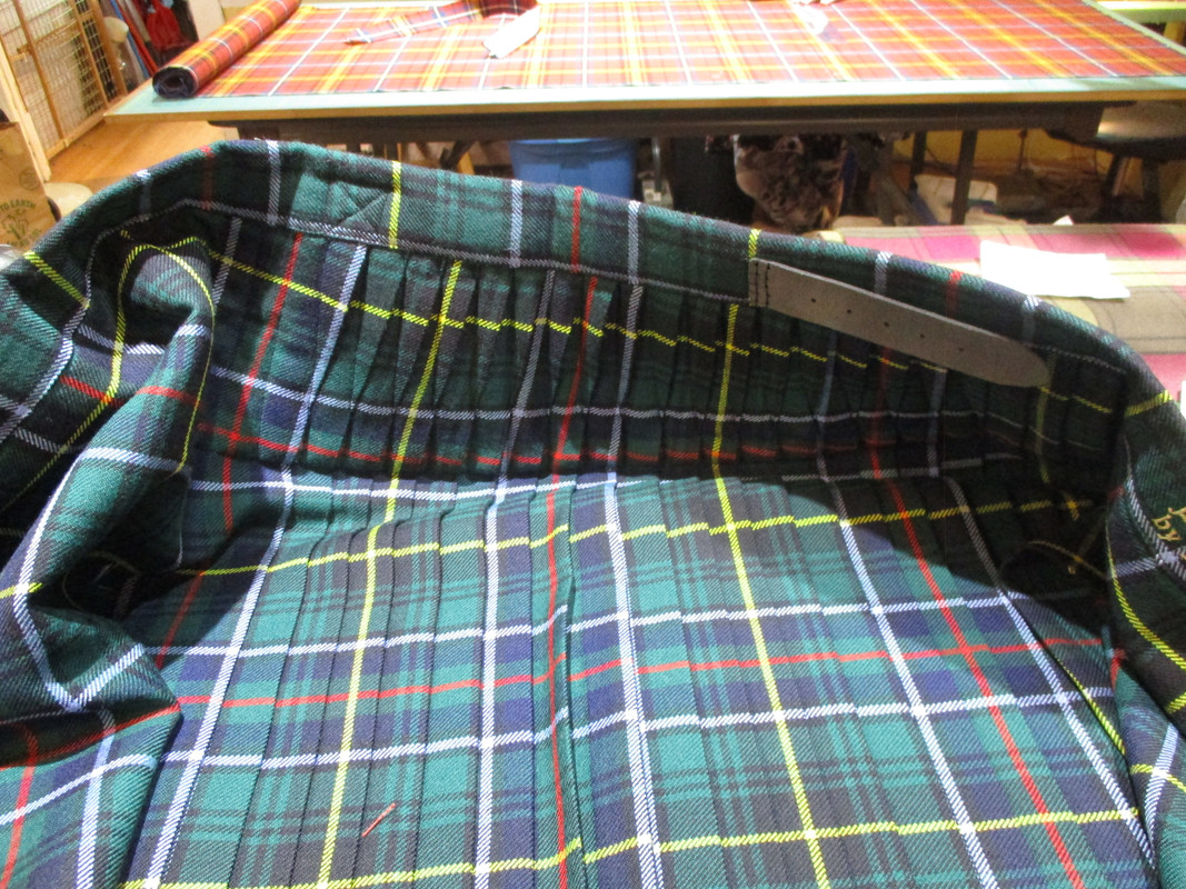

    However, from the outside, this kilt looks very much like an iconic kilt.
    Now please remember that I am talking about my Contemporary kilts. It is possible using the Contemporary kiltmaking method to make these two kilts exactly the same way.
    On the left is what I call in internal waistbanding and on the right an external waistbanding with beltloops. While they give a totally different look to the two kilts, they are both constructed exactly the same. Some customers prefer one appearance, other customers prefer another appearance.

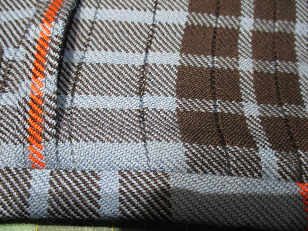

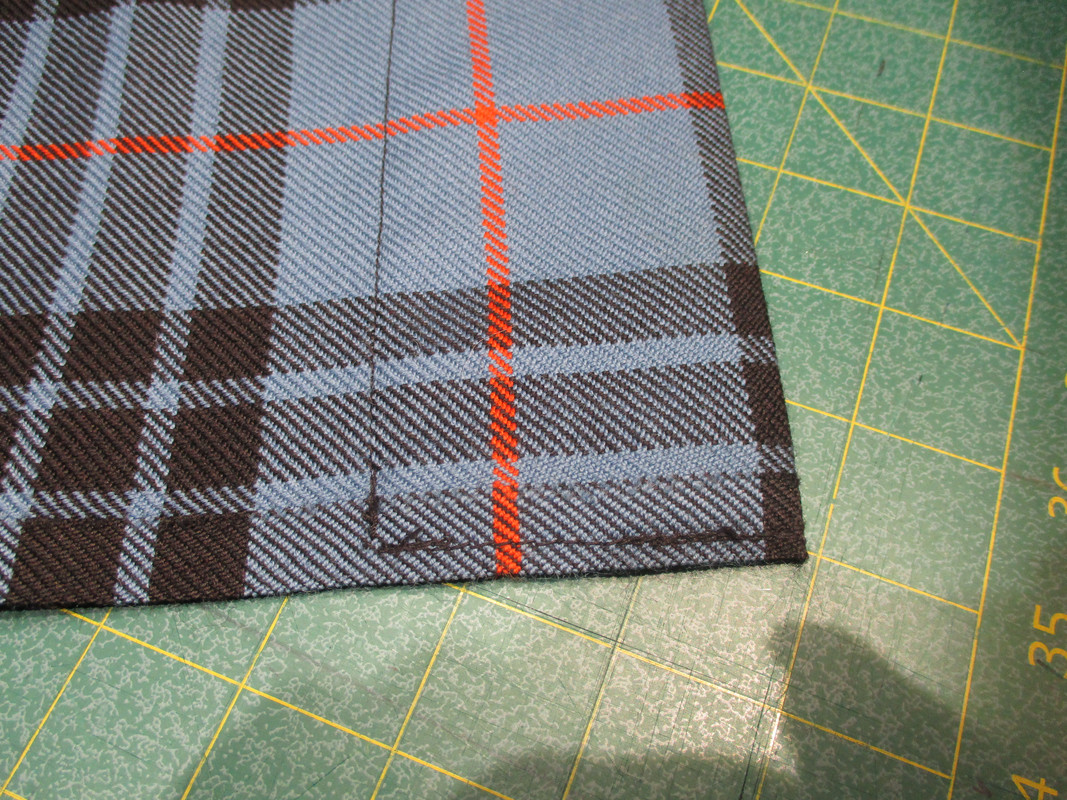

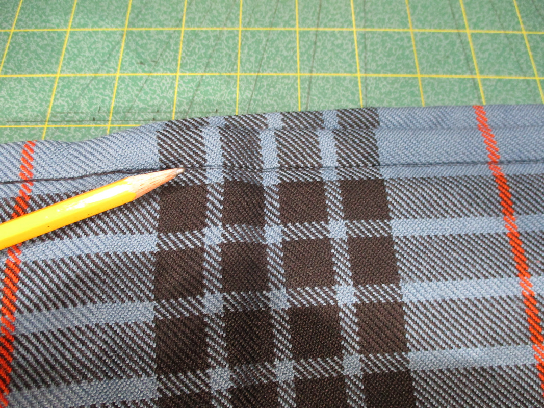

    This is a totally machine stitched kilt using the technique known as "blind machine stitching" where the pleats are stitched open and then folded back after stitching to hide the line of machine stitches.
    Here you can see the line of machine stitches known as "Stitching in the ditch" that fastens the waistbanding.

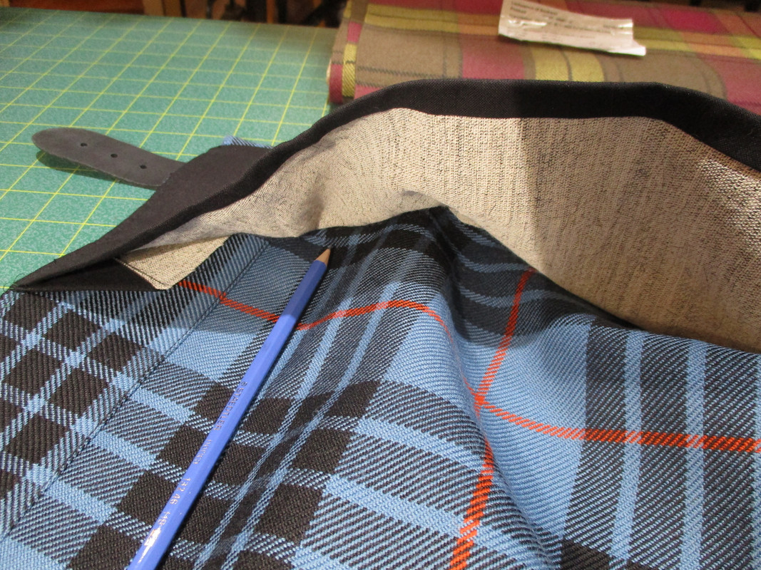

    There is single piece of interfacing behind each apron.
    But this piece of interfacing is not attached to any other structural element of the kilt. Where you see the pencil pointing is where the strap is sewn, not the the interfacing but just to the outer Tartan fabric.

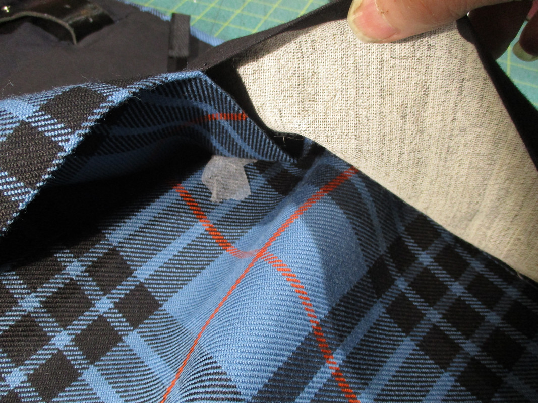

    On the under apron you can plainly see the small piece of fusible that was intended to hold the Reverse Pleat in place. But it is not even fully melted as would be expected.
    This lack of internal strength has already caused permanent distortion to the Tartan fabric.
