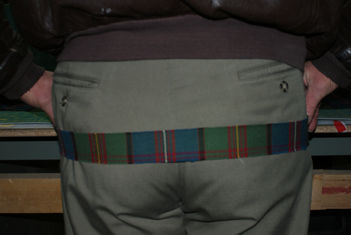

    If may offer an alternative method. This is how I teach it and is the method used in THCCK. The principal behind this method is the classic High School Geometry lesson - How to divide any length line into any number of equally spaced divisions.
    1) Cut a length of fabric from your center strip long enough to go around your backside with your choice of front apron center element centered in the strip.

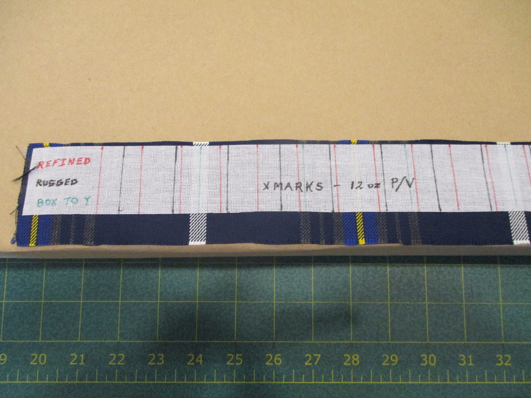

    2) To stabilize the Tartan strip and provide an easy writing surface, iron on a piece of iron-on waistband interfacing.
    3) On your lay-out table construct a "magic starburst". A series of lines beginning at a single point, radiating out to any number of equally spaced divisions. How many lines you draw and the spacing at the bottom will depend on the size of your lay-out table. Using masking tape makes the starburst easier to see and also allows it to be temporary, one-time-use.
    4) Lay your Tartan strip on the lines of the starburst. Keep the Tartan strip horizontal and temporarily center your front apron center element between any two lines. (Green Arrow)
    5) Slowly move the Tartan strip vertically up and down until any two pivot points are on any two starburst lines. This will divide your Tartan Sett into a number of equally spaced divisions. At this point don't worry about how many divisions. Draw a line on your table at this height so you can measure the width between lines easily.

    Once you have found a place on the starburst that has a pleat width that you like (approx. 5/8" to 1") and the lines fall in good parts of your Tartan pattern (A pleat crease will not split a Tartan element or cause a Sett element to disappear when you Taper the Fell Area) Mark your iron-on waistband interfacing.
    8) It is now a very simple thing to lay your Tartan strip right on your kilt fabric and mark the pleats according to the marks on the strip.
