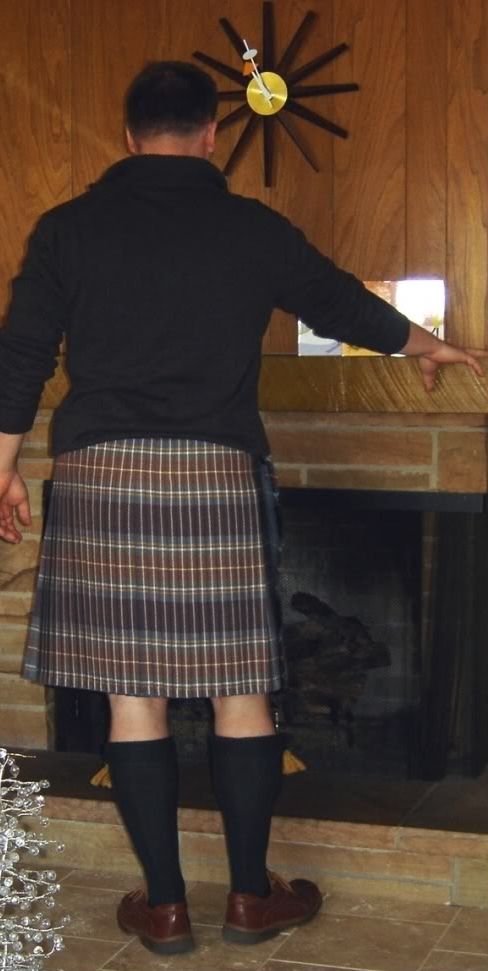

    Gwynng , I agree with Jon . There are many possibilities . As Jon said pleating to the block is also an option .
    Here is an example of pleating to the block , Montgomery Blue ( modern ) , Batley Mill , pleated to the block .
    As Jon mentioned , with this method , there is a flash . The red vertical stripes appear when the kilt swishes as illustrated on four of the pleats .
    Just food for thought , good luck on making your new kilt !
    Cheers , Mike

    Gorgeous flash in the Montgomery! It illustrates what's necessary for flash - a bright stripe hidden just beneath the pleat reveal. If it isn't bright and contrasting, and it isn't directly below the edge of the pleat, it won't "flash". Only a few tartans do this really well (e.g., http://www.xmarksthescot.com/forum/f...-stripe-67124/ and http://www.xmarksthescot.com/forum/f...n-flash-78526/). And you have to make sure that you don't gain lawnchair as well as flash.
    Holyrood isn't really right for "flash". The only opportunity is to pleat to the solid blue block, and then you'd have killer lawn chair.

    When xman made mine I requested it pleated to the white stripe, and was VERY pleased with the result.
    I do love a kilt pleated to the stripe.

    Artificer - I like that light stripe option a lot. That may be the winning option. Thanks everyone.
