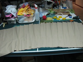

    Here's the fabric, after washing and cutting it to width:

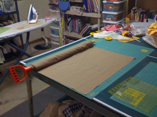

    It's wound around the traditional kiltmaking tool, a snow shovel handle. (I knew I was saving it for something!)

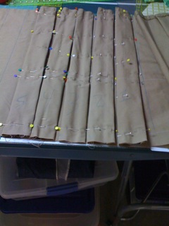

    One thing I'm doing differently from Alan's instructions is that instead of cutting the fabric to length, I've left an inch or inch and half allowance at the waistband. I had plenty of fabric width (60" wide, 24" drop), and it's made a number of steps easier. I scribed a line for the waistband and the fell, and have used those for reference. The lines don't show up well in this pic, but they're there
    at this point, I've pinned the outside edges of about half the pleats, in preperation for edge stitching them.
    That was a pain, but it turned out okay, and I only had to rip out three or four of them. (Note to self: don't try and put in 1mm stitches!)

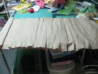

    did some work at lunch time:
    Here are the tapers sewn in (can't really see it, but trust me)
