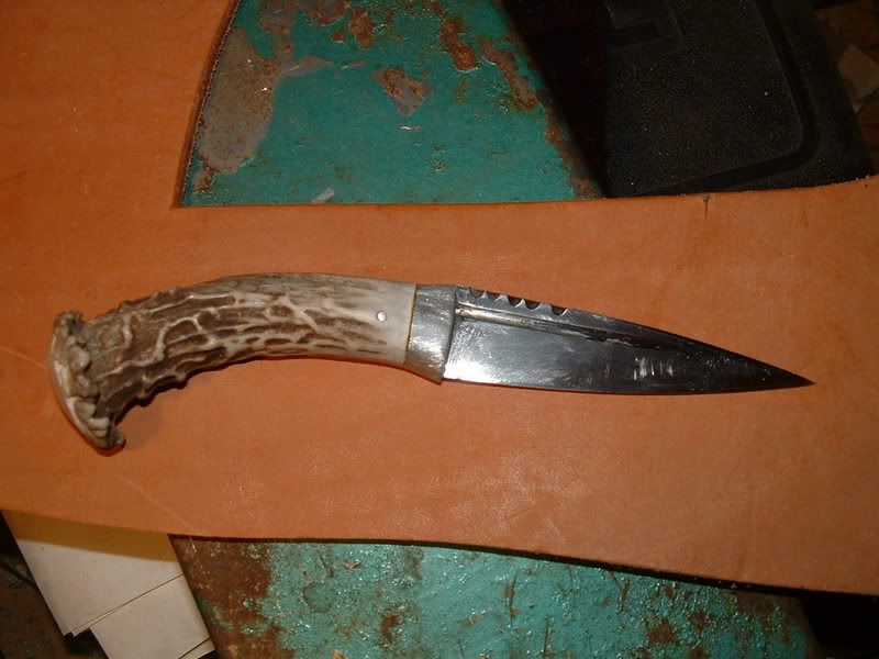

    Sorry that it has taken so long to get back to this thead by work and family has kept me away from my shop.
    I don't use a belt sander just hand files and sand paper.
    these are the tools that I use to shape the bolster
    the file card is used to keep the file clean while you file.if they are not clean it will leave marks in the metal
    shaped and ready for sanding
    I'm an 18th century guy born into the 20th century and have been dragged kicking and screaming into the 21st century.
    We do not stop playing because we grow old, we grow old because we stop playing"

    Final finish is given using 0000 steel wool dipped in linseed oil
    rub it on and buff until you get a shade darker than you want to finished product to be as it will wear lighter over time and use
    I also warmed up the blade a lilttle with a propane touch and applied a cold blue solution you can by at any sporting goods shop
    this gives it an antique appearance

    The only thing left to do is sharpen the blade and make a sheath.
    I did the sheath lay out earlier after I had roughed out the bolster
    By the way this sgian needs a home and will be ready to ship after the sheath is completed. if your interested PM me
