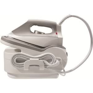

    And here is one now available for home use.
    The advantage is lower cost but they also will not generate quite as much steam and not last as long before needing to be repaired or replaced.
    Steam generator irons, because the steam is created in a separate tank, do not need to get the iron sole plate as hot. This lessens the shiny spots that a normal iron can make.
    Remember, that when looking for a new iron for your kilt maintenance, it is the steam that does the work of heating the fabric. So get the iron, within your budget, that creates the most steam
