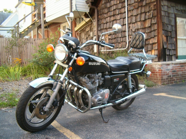

    Great old bike! I ride an antique myself, a 1978 Suzuki GS750. One thing to remember, the project never ends You will always find something to replace/repair/remove lol.
    Here is an older pic of mine, little different now, I'm playing with painting the engine and other parts.
