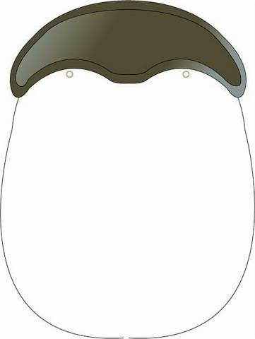

After continually tweaking some of the proportions, I think I am close to where I want the Stewart cantle to be.
For reference, the Stewart cantle is "F" in the below image:
I'm hoping to have that Muirhead construction conversation with the STM this week, which may change a few small things, but not to the eye of the observer. They would all be internal alterations.

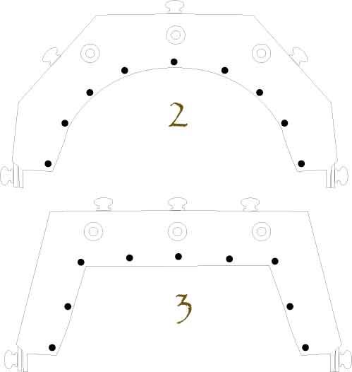

As I was sitting here assemblijng a leather cantle and contemplating the long delay for the second shape I was staring at my concepts board and a feeling crept over me. The feeling that perhaps the two cantles were a touch too similar in shape.
After I drove the harness needle into my thumb (again), I decided to take a break and whip up a quick alternate to hopefully get feedback from all of you on.
Here it is, cantle #2 (original) vs cantle #3 (new concept).
The top and inside corners would be slightly rounded, this is just a rough drawing.
Any thoughts?
I'm personally inclined to steer toward #3. Some of the best things I've ever come up with have been a last minute 'bolt from the blue'.

Both look good to me.

Don't discount MoR's comment. You should produce both square top versions. They each produce different effects, and each have their own appeal.

Unfortunately I'm most likely limited by just two styles to start. The material used to make the masters is EXTREMELY expensive (think the cost of a good L&M sporran per master). Also, the shop time (which I'm not paying for on the first two, due to my making the smith's harnesses for his full plate armour) to set up for a master is very expensive as well (more expensive per hour than a plumber or electrician).
Should the response be solid for the first two styles, I may initiate the third.
I am still investigating pewter casting for the MacLeay non-functional cantles, and I think it's a pretty good way to go for extremely limited run pieces. Most likely I'll start mastering the first piece after the holidays.

I'm giving this a bump here to hopefully get a few more opinions on the second cantle shape.
#1 is the round top, and is already in the works.
Below are the options for the other shape.
I should add that the outer and inner corners on #3 would be softened and slightly rounded, this was a quickie sketch to cement the idea in my head.
So, which one is the favorite? I'm personally leaning toward #3 as it is further in shape from the round cantle, giving a bit more variation than #2 would.
Thoughts, anyone else?
