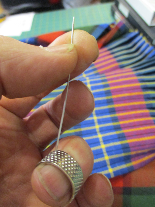

    When stitching pleats - due to the way I support the weight of the kilt on a table in front of me because I stitch left-handed - I always stitch in the direction from the hips to the waist. This allows me to control the tension on the fabric with my right hand and the needle in my left.
    I also press my pleats before sewing and use pins as I work.
    Barb likes a leather thimble. I prefer a British style ring thimble and learned to hold my needle like a British Tailor.

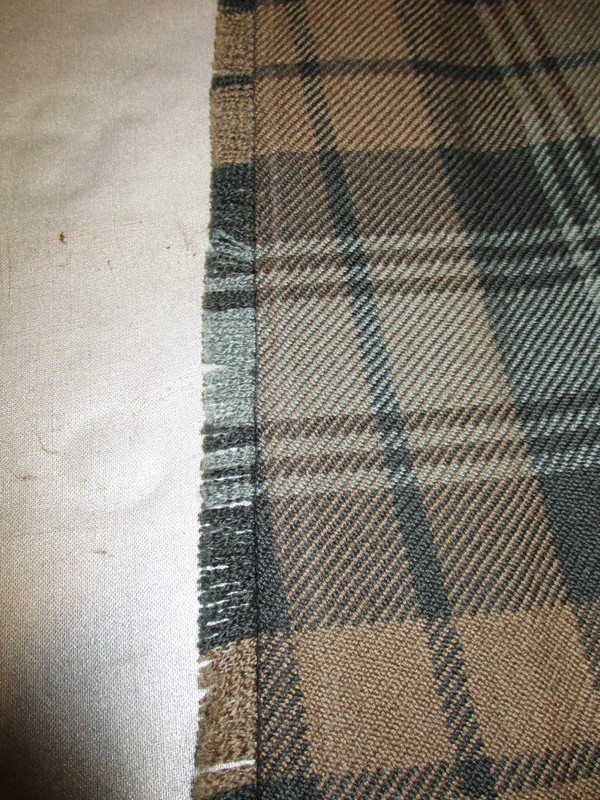

    The liner on the inside of the kilt is only there to hide the internal strengthening elements. It is usually made from a cotton boadcloth and can be replaced if needed without needing to disassemble the kilt. the liner should be fully sewn on all the edges. There should be nothing to catch or snag inside the kilt.
    In fact, one of the dead give-aways that a kilt is not made to be of heritage quality is when you can lift the liner, find any interfacing sewn to just the liner, an and the pleat cut-aways allowed to fray.
