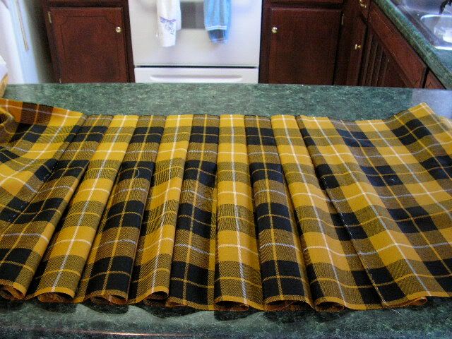

    Sooo how do you intend to pleat it?
    To the sett? Maybe a stripe?
    Or do we have to wait for the photos?
    The sett for this tartan is 6". I am going to use 3" box pleats and use 1.5 setts per pleat. In effect I am pleating it to the sett. Matt gave me the idea before I ordered the material. You don't usually get a box pleat to the sett. We'll see how it goes.

    I did mark out the aprons and pleats this morning. No pics of this. I did notice that while marking it out that it was a lot easier to work with two 2yd pieces rather that two 4yd pieces.
    Next will be to sew up the pleats. But I will need to get some thread to match. I might just baste up the apron edges in the morning and get the colored thread during lunch tomorrow.
    I probably won't have any more pics until the pleats are done.

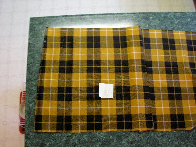

    2nd April 05
    Smyrna, Tennessee, USA
    978
    I basted up the aprons this morning. And I got my thread during lunch. While at the fabric store I spotted this tartan material. It was 100% wool and a twill weave. It had a hard finish, so I assume its worsted. It felt light and had a small sett, so probably around 11oz. I reminded me of some of the Irish county tartans. It was $12.99/yd. I might have to go back. For future practice of course.

    2nd April 05
    978
    Any pics of the work in progress?
    Not that these are very interesting, just pics of the basted aprons. But I guess the folks here are pic crazy.
