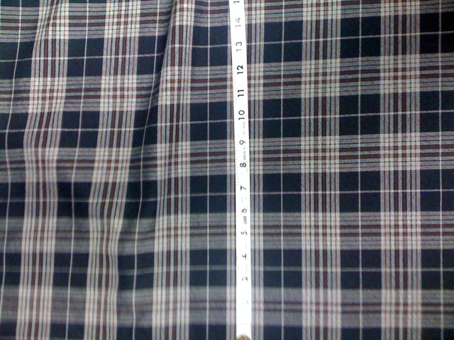

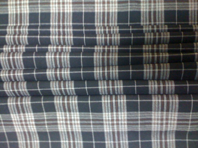

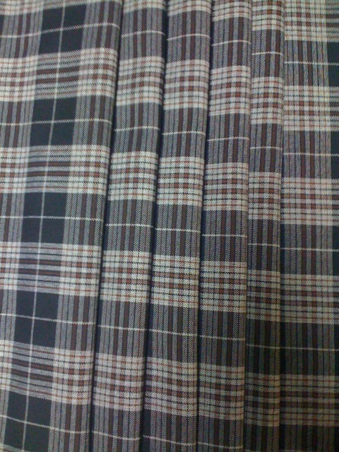

I've acquired a piece of a fashion tartan, which I'm going to pleat up into a kilt.
I'm thinking it should be pleated to the white stripe.
(sorry for the crappy pictures. I only had my phone handy.)
As you can see the sett size is about 3.25", which I think means I should use two setts when pleating, right?
Reason: don't post when sick

To my eye this white stripe is not prominent enough. You'll get so called "lawncahir" effect. This can be even more critical if you are the man with bigger waist/hip line; man f the substance.
But after all it's just my opinion. If you like it, do it. I think pleating to set would be better in this case.
Regards!
Mipi
Whatever you decide, good luck and steady hand.

Yup, major lawn chair. Try pinning it up to the brown stripes inside the white -- the effect will be very light, but maybe your only choice other than sett.

I think your best option for this one is to pleat to the sett, and use two setts for each pleat.

yeah try the sett. to the small white strip is toooo lawn chair.....the other way is a bit busy looking.

Beauty is, as they say, in the eye of the beholder. I see nothing wrong with the 'lawn chair' effect. I think we have all been conditioned into thinking that it is something to be shunned. I don't see why.
The tartan is quite light, almost a 'dress' tartan. Pleating as in the second attempt would give a very light kilt - possibly too light. Whereas, pleating as in the first attempt will give a darker contrast, front and back.
I think that the sett is to small to effectively pleat to the sett, so I would go with first picture.
