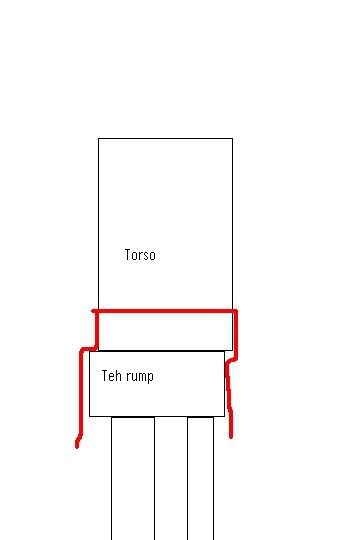

    Ok, i think I'm getting this now....The apron does not taper.
    otherwise it'd look like this
    Now that I understand that, tiem to start it up

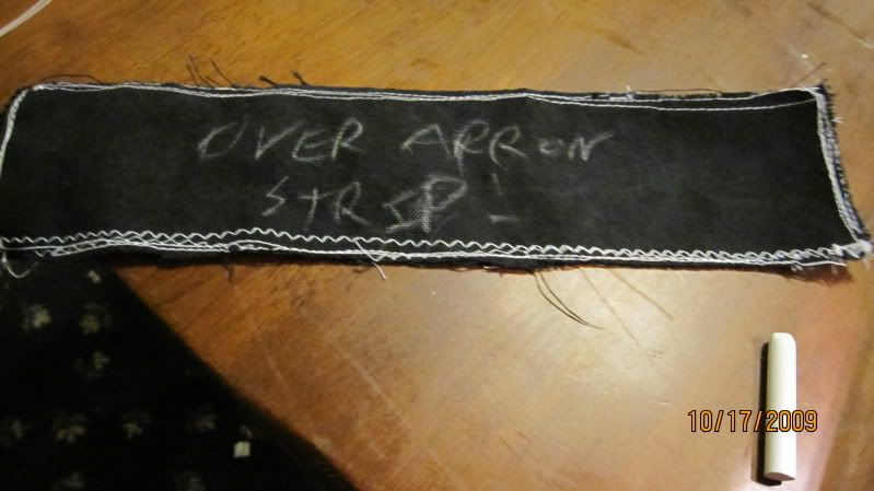

    Anyways, then I made my apron strip.
    I know it looks messy, but I made sure it was SUPER TOUGH.
